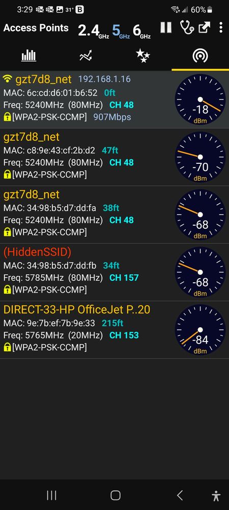

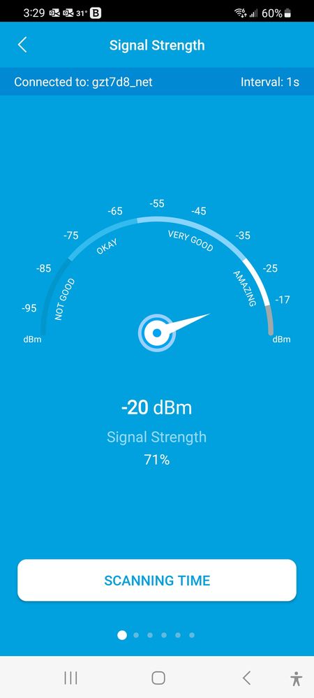

Well, I don't have an answer for that. Here are 2 screen shots. This is one of the satellites in the bedroom, first photo is the WiFi Analytics from the Orbi (Android) app. It shows a strong signal strength.
The 2nd photo is from a Wifi analyzer, where it shows my mesh network, 3 listings of my network, gzt7d8_net, and the top one is listed shows I am 0 feet from the satellite. The other two is the router 38ft away and the garage 47ft away.
Not compatible, but for some reason, connected.
