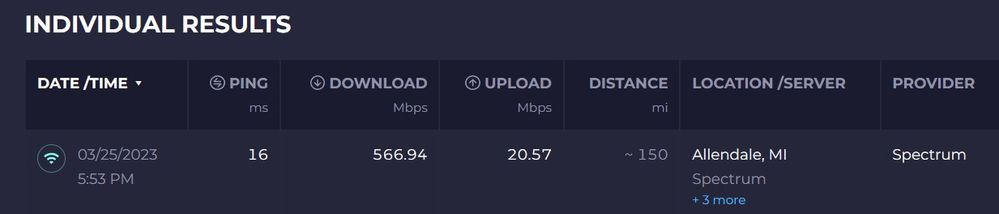

- GregS_from_MIMar 25, 2023Apprentice
Good call, About CrimpOn - NETGEAR Communities
I took one of the 750 satellites and hooked it up to my desktop.
And run a speed test. So yes to your point, it appears the 750 satellites are compatible with the 860 routers.
- CrimpOnMar 25, 2023Guru - Experienced User
What a hoot! Thanks for taking the time to do this experiment.
So:
- compatible in the sense that devices can connect to the satellite and get network access.
That's the reason for the Ethernet connection.
Puzzled why the WiFi symbol appears on the Speed Test:
- not compatible in the sense that the router apparently does not recognize and report the satellite.
- makes a person wonder what else is not compatible.
- Will devices roam seamlessly between the 860 and 750 access points?
- If Guest Access is enabled, will it be enabled also on the satellites?
- If a WiFi password is changed, will that propagate to the satellites?
- What about Access Control?
Would hope that the computer showed up somewhere in Attached (or Connected) devices.
