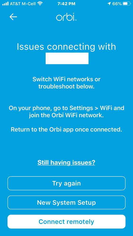

Orbi App not detecting RBK 753s
The app is not detecting the router locally but if I use remote management option I can see the router and satellites. Is this a bug that needs to be fixed? thanks

Well, that was pre-mature. Upgrade to APP V2.5.5.1124 yesterday, and after waiting overnight the wireless access is fine but the APP no longers finds the RBR850. I had a RBR850 reboot yesterday - guess that's why it worked for a while.
The error screen I get is exactly what FURRYe38 posted above
Bummer, Netgear - please help
