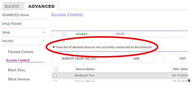

On my RBR50, the Advanced Tab, Security Menu, "Access Control" contains a table of devices which are connected. I have so many devices, that I have to scroll down the web page to find this table of "Allowed Devices which are not currently connected":
When Access Control is enabled, the router has to keep a record of every device that was ever allowed so that if the device ever shows up again, the router will remember it. There is also a table under that of Blocked Devices which are not connected (so that the router can remember that they are not allowed.)

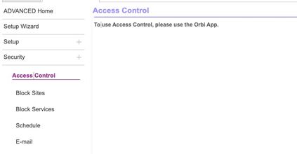

- mikev123456789Jul 04, 2022Tutor
CrimpOn That view isn't available to me unfortunately. It just says to use the app. Definitely doing it through the portal would have been alot easier than doing it 1 by 1 through the app.
- FURRYe38Jul 08, 2022Guru - Experienced User
I believe NG has removed the web page UI for Access Controls so you have to use the Orbi app now.
