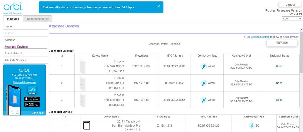

I have an RBR50 with three RBS50 Satellites which has been running well for years. My RBR50 and all three satellites are running firmware V2.7.4.24. I've recently upgraded my I-phone ORBI app to Version 2.31.0.195. The I-phone App does not show any connected satellites on the Network App or on the home page. It also does not show any Ethernet connected routers -- all it displays is the RBR50. However if I access my RBR50 Router via the web browser, I see all three routers connected via wired connections (Attached).
I've tried this from different I-phones or I-pads with the same result. Wondering if this is a bug with Orbi App 2.31.0.195 ??
Any ideas appreciated....this appears to be an Orbi app problem since the network is running well and the accessing the RBR50 through the browser shows all satellites and the devices connected to the satellites.
Absolutely. You can "shake the phone" and report the bug. (Not exactly Cardio, but perhaps stress relieving.)
