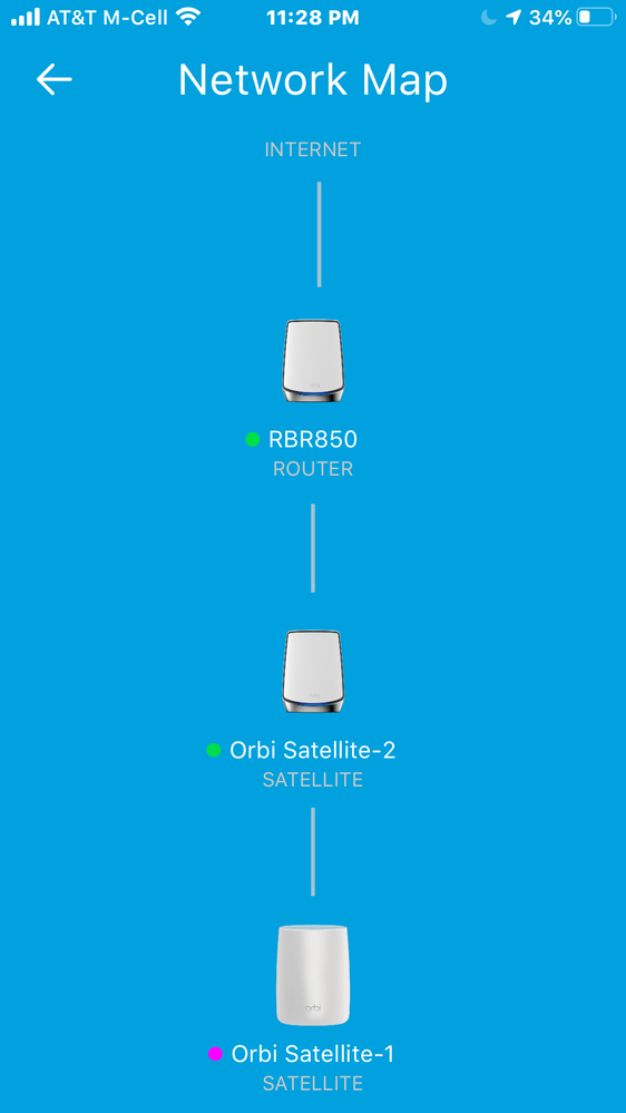

RBR852 - App started showing an additional satellite
This is a recent issue, the Orbi app is showing an additional satellite that does not exist using the RBR852 system. Rebooted, re-installed the app and still appears. I only have one satellite and my ...
- Jun 27, 2020Finally solved the mystery satellite issue in my Orbi app. Had time to do a complete factory reset and set everything back up from scratch. I believe my back up config file imported something corrupt and caused the issue of the "satellite-2" showing that was never there.

Yup, web gui shows everything perfectly... Only the app shows the additional old style satellite.

Another user in the AX forum noticed and additional satellite showing in his system as well (RBR853)
There is definitely a "bug" somewhere

Hey Furry and KMDonlon,
May you try updating/reinstalling the Orbi app and letting me know how it turns out. We recently released iOS v2.5.3.18.

- KMDonlonJun 16, 2020VirtuosoTried an uninstall and reinstall a while back and just now. No change

Hi Furry and KMDonlon,
Thanks for getting back. May you try changing the name of the satellite that should not be reported in app. Let me know how it turns out!

Hi Christian_R
So I removed the app and installed the newer app same version you mentioned. With only 1 of my RBS850s online, app still reports this other RBS thats not online. My 2nd RBS850 isn't even turned ON. The RBR850 was factory reset today and put online in router mode about 30 minutes ago.
Ill turn on the 2nd RBS850 I have and see what happens in the app tomorrow.
