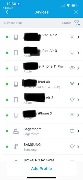

Some device ps not showing full signal strength with Orbi WiFi 6
I just installed an Orbi WiFi 6 mesh system. Some of my devices are not showing full signal strength on the Orbi app (as per photo). The devices are connected to the same satellite station, and ...

- AChangJun 25, 2023Aspirant
If I turn off the RBS, there is no change in the signal strength displayed in the Orbi App on the devices in question. I should point out that the devices themselves show full signal strength (but the signal strength on the Orbi App shows a weak signal). I am not sure if this is just a problem with the Orib App as the devices connect to the internet fine.
I am running the latest firmware (V6.3.6.4_1.2.68) which was confirmed by the Netgear Consultant. I am connected to my NBN modem and my service provider is Optus. I don't know who makes the NBN modem, but everyone gets the same modem (the NBN is owned by the Australian Government).
The Orbi is connected to the NBN modem using Cat6. My home is not that large, and I can see Orbi router and satellite are in direct line of sight from each other (around 30 feet away).
The 5GHz is set to Channel 40 (which was the default), and the 2.4GHz is set to Automatic.
The Netgear tech did try changing the channels on the 5GHz to 48 and then to 60(DFS) but it had no change.
- FURRYe38Jun 26, 2023Guru - Experienced User
Probably a minor bug in the Orbi app. Might submit a bug report with your data, info and screen capture:
