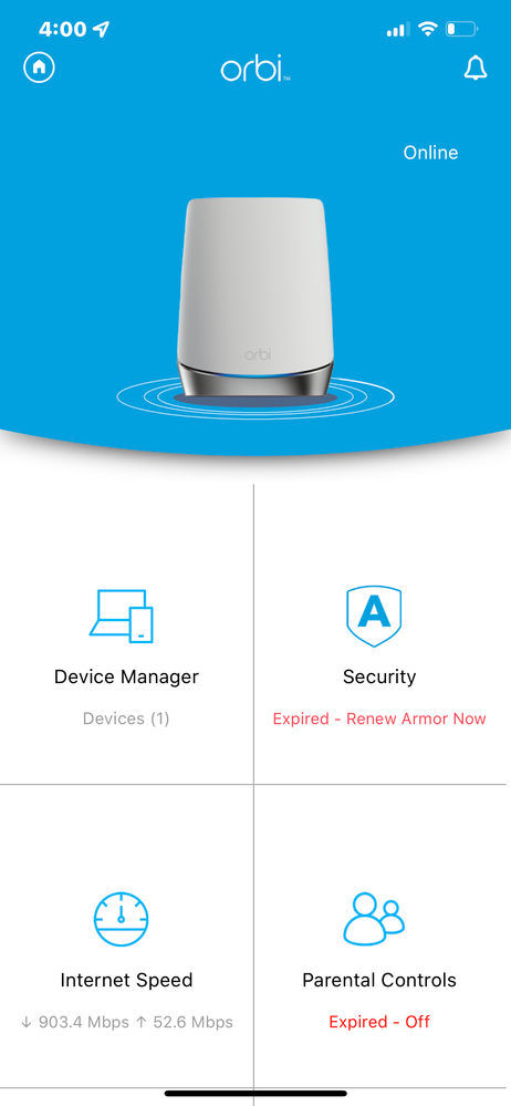

- FURRYe38May 12, 2022Guru - Experienced User
Try a reset and setup from scratch on the RBR with a wire PC or laptop and web browser first. Once it's fully setup that way,
Try accessing the RBR using Orbi app. If your Apple device user, disable these on the Apple device first before launching Orbi app;
Im able to access my RBR with my Iphone ok:
