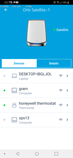

the pause/resume functionality is not enabled in Orbi app with RBR750 router
I use Orbi for +4 months, and I usually can see this form in the Orbi app: Today to my surprise I've seen briefly this instead: Unfortunately I'm now back to first si...

I finally was able to figure out the following:
1. the android app can have 2 modes, where 10x buttons or 8x buttons are displayed on its main screen
2. when it only has 8x buttons the "Parent Control" + "Support" are the 2x buttons actually missing from the full 10x buttons configuration
3. when 10x buttons are displayed you see the first screenshot (no sliders)4. it is the 8x buttons screen when the sliders are displayed (second screenshot above)
I've also noticed you can get the 8x buttons screen mode for a short period of time after logging in to netgear account. You do the following:
1. go to Support/My cases => you always get a message about some timeout đ
2. do this again, but now you are asked to login to existing account
3. while login in observe the 8x button screen is displayed. Then quickly go into "My devices" and see the sliders are there.I hope this helps,
