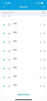

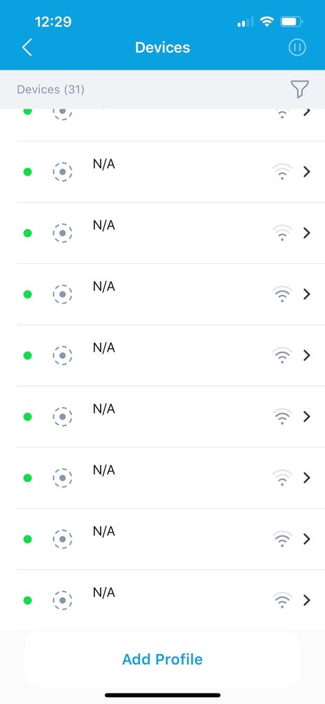

Wifi device names in ORBI App as N/A
After latest FW update of my ORBI setup and I am using latest Orbi app on iPhone too: the names of the devices attached to Wifi (either 2.4g or 5g network) now displayed as N/A, though correctly show...

Update: what worked for me was to delete the Orbi app, including its data, and re-install from the App Store. It will require to login again to the Netgear account, and then will find Orbi on the local network and will prompt to login as Admin. Now device names are correctly displayed.

Thank you, I will try that. However, there are devices that are WIFI connected to the router and satellites - in all cases device names are N/A

Another interesting thing happened after latest FW update of my ORBI setup and I am using latest Orbi app on iPhone too: the names of the devices attached to Wifi (either 2.4 G or 5g network) now displayed as N/A, though correctly shown on the Orbi admin web page. What is this???
