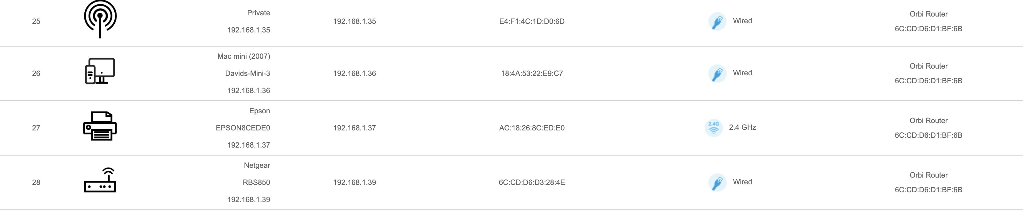

Now that I look again at the connected device list I see that the the software sees the new satellite as a router. I wanted to up load a screenshot from Orbilogin of the connected devices, but the forum software is too buggy. Sigh. But typing out some lines from the device list:
Device 22 "Private" 192.168.1.35 wired "Orbi Router" and then a hex string
Device 26 "Netgear RBS850" 192.168.1.39 wired "Orbi Router" and then the same hex string
My reluctance to go through an extensive rebooting process is because there are cloudflare tunnels and port forwarding considerations, all of which have to be restarted separately. I do have one computer, connected via ethernet to a satellite tthat itself has ethernet backhaul which is on a fixed subnet IP address. However when I do eventually have to do it I will follow the sequence you suggest. Thank you. What I would like, if possible, is suggestions I might try before rebooting.

However so far that hasn't changed the issue that 4th satellite, the new one, is not showing up as a satellite but as a "router"
Personally I found my system hanging when I tried to upload a .jpg. No doubt it was my fault, it generally is, however I have uploaded many, many images to many forums without too much trouble in the past. 🙂 And run my own website etc.
