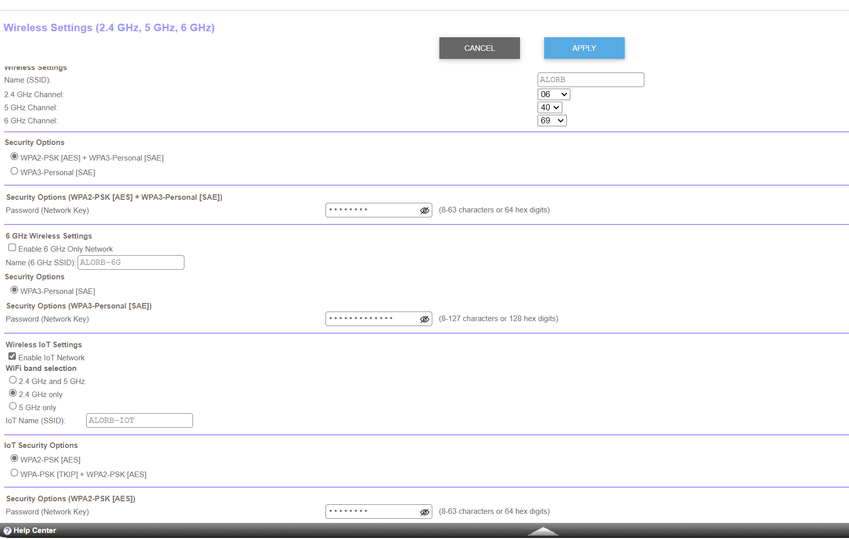

So i turned off both my RBS but there is NO WAY to set the password to null. I have tried blank, and as you suggested, NONE. But it states im not hitting the default minimum password. I changed the password to something simple like 11223344 and still not able to connect.

My Wifi RBR Config is attached in the screen shot
