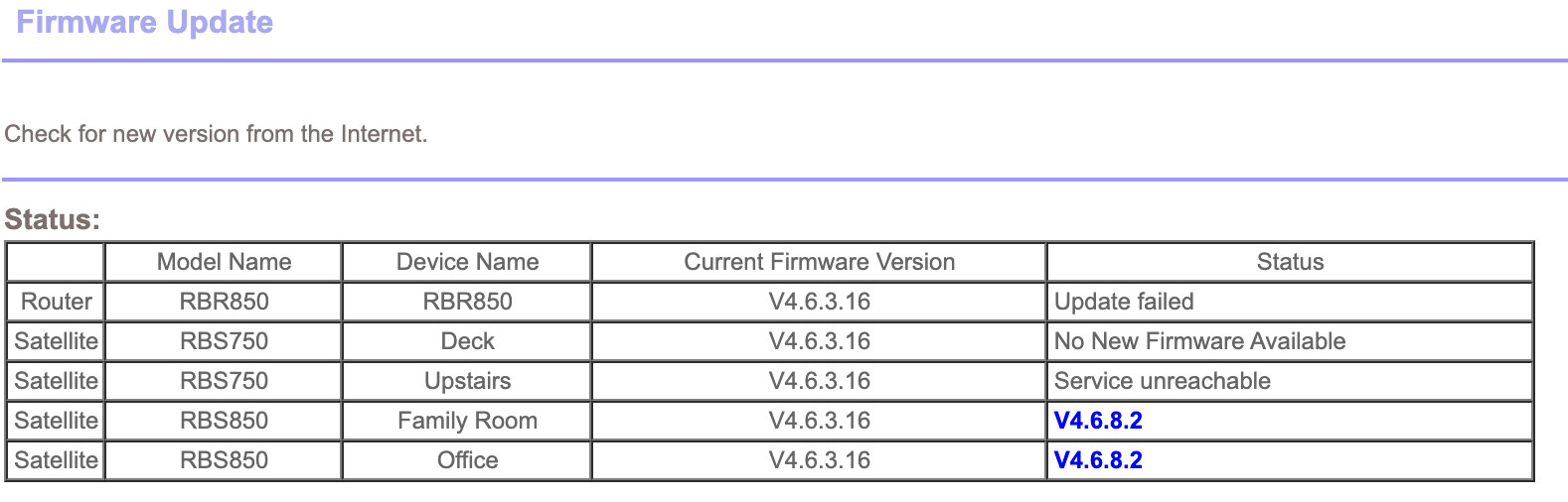

A Quadfeca of Firmware Update issues
Issue 1: Router Update Failed
Issue 2: 750 Satellite No New Firmware Available
Issue 3: 750 Satellite Service Unreachable
Issue 4: Because of this "Update All" is not selectable
I've tried in multiple browsers. I've tried via the app (I get "Firmware Check Error"). I'd rather not factory reset my whole system...any other tips?

    If the goal is to update the router and those two satellites, it appears that the Manual Update process is the only thing left.
    (assuming that you REALLY want to make this happen)
    Download the firmware zip files from the Netgear support sites for the 750 and 950 products.
    Extract the images from the zip files.
    Connect directly to the IP address for each satellite and select the menu item Firmware Update.
    Connect to the router and select the Manual Update tab.

    Instructions on how to manually update FW is here:
    https://community.netgear.com/t5/Orbi-WiFi-6-AX-and-WiFi-6E-AXE/New-RBR750-RBS750-Firmware-Version-4-6-8-2-Released/td-p/2217844/jump-to/first-unread-message
