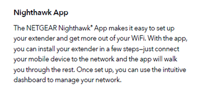

- This product is clearly intended to connect to the Nighthawk line of WiFi routers.
using both the Orbi and Nightawk apps could be annoying. - That talk of "smart roaming" is not likely to apply to non-Nighthawk products.

MarcB376 wrote:
I fail to see where the product is listed to be used with a NIGHTHAWK line.
To me the tip was:
Products intended for the residential Orbi products use the Orbi 'app', not the NIghthawk app.
This is why I have reservations about how "integrated" this product will be with an Orbi system.
