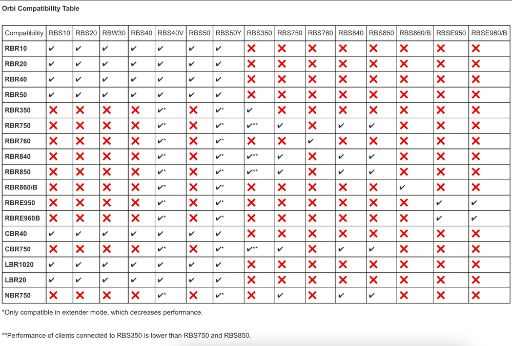

The other was two compatible satellites that they suggested will work with my setup which are RBS40V & RBS50Y
After doing some digging on the website I did manage to find this table which says the above but also says
" *Only compatible in extender mode, which decreases performance."
