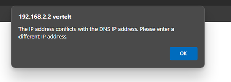

Add reservation error
Trying to add a reservation for my setup box. I get the following error when clicking apply.. The reservation itself I selected from the selection list. So it has to be correct. Any ...

Thanks for the reply. The device is not on guest. My whole network is set to 192.168.2.x That is how I set it up. The strange thing is that the reservation is made and it is added to the list.
Jun 26, 2024Guru - Experienced User
