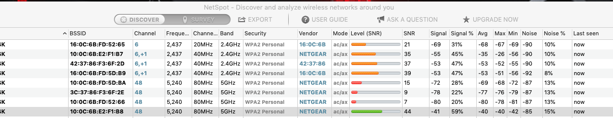

AP mode BUG: RBR750 and RBS750 do not operate properly
Hello everyone, seems I have also faced with the issue as many other already posted here on the forum: Orbi AX4200 RBK753 (RBR750) does not work properly in AP mode with its satellites (RBS750): 1...

Your post made me curious as I have a similar setup (AP + 4 Sats). My setup has a newer FW version, but using wireless backhaul. All 5GHz Channel/Band are as expected. Might want to check out the latest FW version to see if that helps. Good luck!
