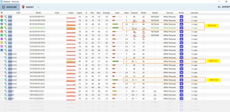

Hello everyone, seems I have also faced with the issue as many other already posted here on the forum: Orbi AX4200 RBK753 (RBR750) does not work properly in AP mode with its satellites (RBS750): 1...

FURRYe38, thank you for linking that post. I just went through it and realized that there is newer firmware version available via your link (V4.6.7.5) comparing to the firmware posted on the official website (V4.6.5.14).
Yeah, I might need to try it out as well, but gosh it will again take few hours... Bit complicated as I am helping my friend in his premises, so will need to arrange time again for new tests...
Anyway, thanks for pointing out to that post. Basically I went through the same issues as mentioned in that post...
