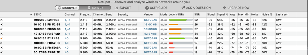

- SW_Jan 26, 2022Prodigy
One thing you could try to verify if the changes are propagated correctly to all Sats is to rename the SSID to something new so that none of your WiFi clients can connect to it. WiFi clients can affect Sat's WiFi "Bands" seen via NetSpot if that client has trouble with 80MHz or 40MHz and decides to switch to 20MHz for better connection.
