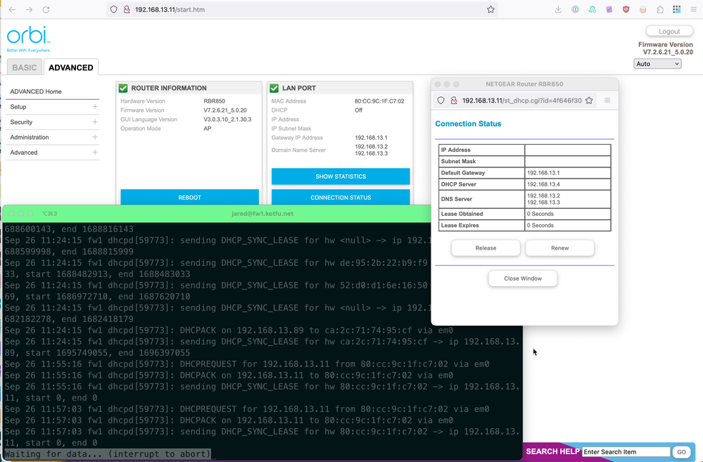

I also observe this bug on my RBR850 with 7.2.6.21_5.0.20. I can also add some additional useful information. If you click on the "Connection Status" button you get a browser popup window that lets you release or renew the DHCP lease on the LAN port IP address. The IP Address and Subnet Mask are also empty in the popup window. Also note that the Lease Obtained and Lease Expires fields in the popup window always display "0 seconds".
When you click the "Renew" button in the popup, it does in fact renew the DHCP lease, but it doesn't update any of the relevant info in either the "LAN Port" card or the "Connection Status" popup. My observation is that this is a display bug only, the LAN port has an IP address assigned by DHCP, and can renew it, it just doesn't display in the web admin properly.
Here's a big screenshot showing all the relevant bits, including the logs from my DHCP server showing the lease being renewed.
