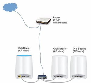

Hi, Does this wiring work with AP mode setup? or does everything still need to connect back to the orbi router? I found the image on google. Thanks! RBS750 Firmware Version V4.6.11.1...
CrimpOn
Mar 15, 2023Guru - Experienced User
Helpful person on Google was mistaken. The correct method is to connect from the ISP device directly to the router WAN (yellow) port.Then from one router LAN port to the switch (as shown). Move that one cable.

- CrimpOnMar 15, 2023Guru - Experienced User
I am confused.
- The ISP device is not located physically near the router.
- There is one Ethernet cable running from the ISP device to the location where the switch is.
- The router and the switch are located at the central wiring hub.
- Instead of connecting that cable from the ISP to the switch, connect it to the router.
- Leave the cable connecting the router and hub in place.
OR.... is the router NOT in the same location as the switch?
