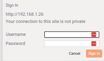

Yes, I get the same result entering the IP of the Sat directly into the browser, as I do from the manual FW update page pop-up. Entering my set password or "password" both just blink. Admin+admin I get a denial. I tried Edge instead of Chrome too. Same
Sep 27, 2023Guru - Experienced User
Can try this to get the RBS updated:
You need to update the RBS before updating the RBR. Keep this in mind for future updates.
What you need to do is factory reset the RBS. Wire connect a PC to the 1st satellite📡. Already have the most current FW version files downloaded on to this PC.
Wire connect 1 PC to the back of the RBS. Factory reset the RBS, wait about 5 minutes. The PC will get a IP address from the satellite📡. The RBS will be 192.168.1.250. Or Set a static IP address of 192.168.1.49 on your PCs ethernet configuration. Use this IP address in a web browser to log in to the satellites web page. Log in as admin and password. Use the satellites 📡 web page FW update feature to select the FW update file that was unpacked from the .zip file. Then factory reset and then re-sync the satellites 📡 to the RBR.
