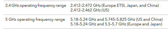

        Most Orbi system User Manuals have a Technical Information section at the end detailing which WiFi frequencies are used for the user facing and backhaul connections.  It is somewhat of a puzzle that the 760 product does not have this information.  The earlier 750 product, for example, states:
