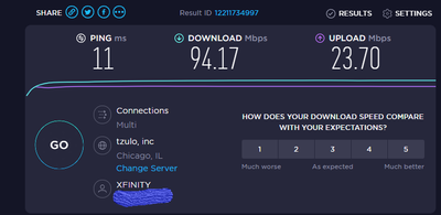

AX4200 Orbi WiFi 6 (RVR750) not serving anywhere near ISP speeds
I've had years of luck with a Nighthawk X6 R7900 and decided to upgrade when I moved. Installed a CM1000 Docsis 3.1 modem (only) and an Orbi Mesh setup - AX4200 WiFi 6 RBR750. Setup went well howev...

What speed test app are you using on the computers? Ooklas Installable speed test app is recommended.
Has a factory reset and setup from scratch been performed since last FW update? A complete pull of the power adapters for a period of time after the factory reset then walk thru the setup wizard and setup from scratch.
I would power OFF the ISP modem for 1 minute. Factory reset the Orbi router and power it off. Power ON the ISP modem and let it sync. Then power ON the Orbi router and walk thru the setup wizard again using a wired PC and a web browser.
- RockoFOct 20, 2021Aspirant
Thank you for the reply. I manually updated the firmware as suggested by Netgear. After this, performed a factory reset from scratch using the Orbi app from a smartphone to step through this install. Still seeing huge descrepancies from the ookla speed tests.
- FURRYe38Oct 20, 2021Guru - Experienced User
And thats with a wired PC? Your ethernet adapter is reporting a connection rate of 1000Mpbs on the PC?
Have you tired changing to a different test server on the Ooklas speed test app to compare?
One test to try, power OFF the ISP modem and connect 1 wired PC to the modem. Power ON and then speed test to check this.
You might open a support ticked and contact NG support about this.
Appriciate the help with this. Unfortunately I've had the system boxed up for a while so upport runs out tomorrow. I've opened a ticket and have been given some settings to try along with the factory reset all with no success.
Indeed, a wired connection which is all the more troubling. Thanks again.
