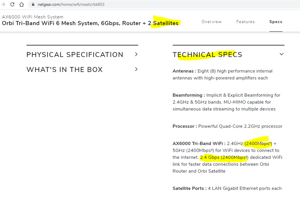

Now some fun: This screenshot does show the confusion and errors which obviously exist in Netgear and on the (new?) Web site - RBK853 -> Specs -> Tech Data -> Satellite ... LOMA ... who can spot all errors?
Does Netgear proof-read specs before publishing? The interesting part - the same RBS850 specas are falsely duplicated insted of re-used.

schumaku wrote:Hmmmm, interesting interpretation - the specs for the router and the satellite show something completely different - reads to me some Netgear support entity with no much tech insight has tried to explain that the wireless backhaul is sufficient for two satellites.

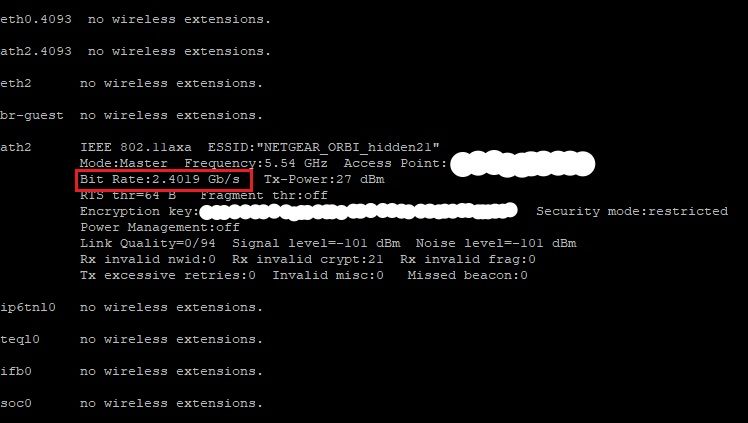

Now, that said, I am starting to side with those saying this is a UI display issue. I finally telneted into the router and get this information (sensitive information <redacted>):
ath11 IEEE 802.11axg ESSID:"<backhaul wifi>" Mode:Master Frequency:2.447 GHz Access Point: <redacted> Bit Rate:286.8 Mb/s Tx-Power:29 dBm RTS thr=64 B Fragment thr:off Encryption key:<redacted> Security mode:restricted Power Management:off Link Quality=0/94 Signal level=-98 dBm Noise level=-98 dBm Rx invalid nwid:59 Rx invalid crypt:0 Rx invalid frag:0 Tx excessive retries:0 Invalid misc:0 Missed beacon:0 gre0 no wireless extensions. eth1.4093 no wireless extensions. eth2.4093 no wireless extensions. sit0 no wireless extensions. ath02 IEEE 802.11axa ESSID:"<looks like a backend admin wifi>" Mode:Master Frequency:5.24 GHz Access Point: <redacted> Bit Rate:1.201 Gb/s Tx-Power:28 dBm RTS thr:off Fragment thr:off Encryption key:off Power Management:off Link Quality=0/94 Signal level=-98 dBm Noise level=-98 dBm Rx invalid nwid:76615 Rx invalid crypt:0 Rx invalid frag:0 Tx excessive retries:0 Invalid misc:0 Missed beacon:0 lo no wireless extensions. eth3 no wireless extensions. eth3.4093 no wireless extensions. ipsecdummy no wireless extensions. ath01 IEEE 802.11axa ESSID:"<guest wifi>" Mode:Master Frequency:5.24 GHz Access Point: Not-Associated Bit Rate:0 kb/s Tx-Power:28 dBm RTS thr=64 B Fragment thr:off Encryption key:off Power Management:off Link Quality=0/94 Signal level=-98 dBm Noise level=-98 dBm Rx invalid nwid:3 Rx invalid crypt:0 Rx invalid frag:0 Tx excessive retries:0 Invalid misc:0 Missed beacon:0 ifb1 no wireless extensions. ath2.4093 no wireless extensions. eth2 no wireless extensions. br-guest no wireless extensions. ath2 IEEE 802.11axa ESSID:"<backhaul wifi>" Mode:Master Frequency:5.785 GHz Access Point: <redacted> Bit Rate:2.4019 Gb/s Tx-Power:29 dBm RTS thr=64 B Fragment thr:off Encryption key:<redacted> Security mode:restricted Power Management:off Link Quality=0/94 Signal level=-101 dBm Noise level=-101 dBm Rx invalid nwid:27534 Rx invalid crypt:12 Rx invalid frag:0 Tx excessive retries:0 Invalid misc:0 Missed beacon:0 ip6tnl0 no wireless extensions. teql0 no wireless extensions. ifb0 no wireless extensions. soc0 no wireless extensions. bond0 no wireless extensions. ip6gre0 no wireless extensions. miireg no wireless extensions. eth1 no wireless extensions. wifi2 no wireless extensions. ath1 IEEE 802.11axg ESSID:"<personal wifi>" Mode:Master Frequency:2.447 GHz Access Point: <redacted> Bit Rate:286.8 Mb/s Tx-Power:29 dBm RTS thr=64 B Fragment thr:off Encryption key:<redacted> Security mode:restricted Power Management:off Link Quality=0/94 Signal level=-98 dBm Noise level=-98 dBm Rx invalid nwid:127032 Rx invalid crypt:0 Rx invalid frag:0 Tx excessive retries:0 Invalid misc:0 Missed beacon:0 ath13 IEEE 802.11axg ESSID:"<looks like a backend admin channel>" Mode:Master Frequency:2.447 GHz Access Point: <redacted> Bit Rate:286.8 Mb/s Tx-Power:29 dBm RTS thr:off Fragment thr:off Encryption key:off Power Management:off Link Quality=0/94 Signal level=-98 dBm Noise level=-98 dBm Rx invalid nwid:133630 Rx invalid crypt:0 Rx invalid frag:0 Tx excessive retries:0 Invalid misc:0 Missed beacon:0 ath11.4094 no wireless extensions. wifi1 no wireless extensions. ath2.4094 no wireless extensions. br-lan no wireless extensions. ath11.4093 no wireless extensions. ath12 IEEE 802.11axg ESSID:"<guest wifi>" Mode:Master Frequency:2.447 GHz Access Point: Not-Associated Bit Rate:0 kb/s Tx-Power:29 dBm RTS thr=64 B Fragment thr:off Encryption key:off Power Management:off Link Quality=0/94 Signal level=-98 dBm Noise level=-98 dBm Rx invalid nwid:0 Rx invalid crypt:0 Rx invalid frag:0 Tx excessive retries:0 Invalid misc:0 Missed beacon:0 gretap0 no wireless extensions. eth0 no wireless extensions. wifi0 no wireless extensions. ath0 IEEE 802.11axa ESSID:"<personal wifi>" Mode:Master Frequency:5.24 GHz Access Point: <redacted> Bit Rate:1.201 Gb/s Tx-Power:28 dBm RTS thr=64 B Fragment thr:off Encryption key:<redacted> Security mode:restricted Power Management:off Link Quality=0/94 Signal level=-98 dBm Noise level=-98 dBm Rx invalid nwid:67888 Rx invalid crypt:7 Rx invalid frag:0 Tx excessive retries:0 Invalid misc:0 Missed beacon:0 - MstrbigDec 08, 2020Master
doghound wrote:Now, that said, I am starting to side with those saying this is a UI display issue. I finally telneted into the router and get this information (sensitive information <redacted>):
alid frag:0 Tx excessive retries:0 Invalid misc:0 Missed beacon:0How were you able to telnet into the router, since there is no provision to do so on the RBR750 router?

Interesting:
ath2 IEEE 802.11axa ESSID:"<backhaul wifi>" Mode:Master Frequency:5.785 GHz Access Point: <redacted> Bit Rate:2.4019 Gb/s Tx-Power:29 dBm - FURRYe38Dec 08, 2020Guru - Experienced User

- balzac92Dec 09, 2020Aspirant
Hello
Just tried on my AX4200 / rbr750
Return form telnet session, using iwconfig.
Same result, backhaul throughput rated at 2400 Mhz !
It's good news ! :smileyvery-happy:

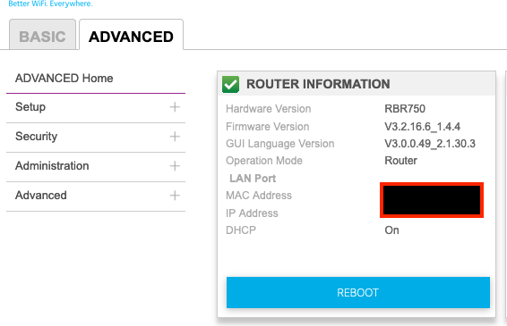

- MstrbigDec 11, 2020Master
Latest Firmware Version V3.2.16.22_1.4.9 does not fix the GUI reporting the wrong backhaul speed. WLAN Backhaul stil shows 1201M.
