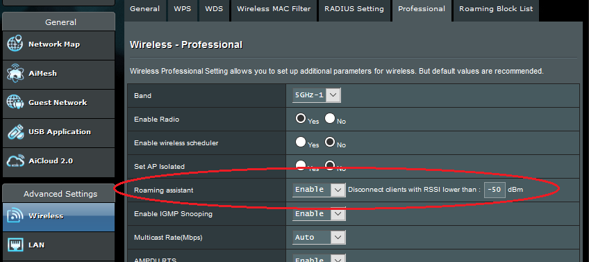

I've actually used both the RBK752 and the XT8. They're pretty similar in terms of coverage and speed wise they were also pretty similar. The one area where they both fail is the handoff of clients between the router and the nodes, both aren't very good with it.Actually the ZenWifi AX has a specific setting that controls the roaming between router and satellites.
In presence of a wireless mesh system it's very likely that, when the device's current wifi signal level falls under a certain threshold, a stronger signal from another AP/satellite might be available,
Through the "Roaming assistant" setting it's possible to set the threshold under which the wireless devices is "suggested" to search for a better AP, for ex. when signal level falls below -50 dBm.
In my experience with the Asus AX mesh system I use "Roaming assistant: Enable" and the signal threshold "Disconnect clients when RSSI lower then: -50 dBm".
I have a very large house (> 5000 sq.ft, 3 levels) with 1 router and 3 satellites, and when moving around the floors on my OnePlus 7TPro I immediately get 867 Mbps when in view of the floor's satellite, no latency.
So changing the threshold from -70 dBm (the default) to -50 dBm in my case gives very good roaming support.
- CallPaulMay 19, 2020Apprentice
I've used the feature when I had an Aimesh setup with two Asus routers and the XT-8. Unfortunately the Orbi
doesnt allow changing the default setting on roaming assist. I've found location and distance between nodes has a lot to do with how clients switch. In my case it's not a concern because most of my clients are in two main areas and even if say I'm on an iPhone 11 I'm still getting 300-400 mbps even though I'm not connected to the closest node when moving around. Changing power levels and lowering transmit power also works when the nodes are not capable of being moved farther apart.
The biggest issue is the clients themselves. I've found iOS devices will hang onto a signal for a long time no matter what parameters are set.
