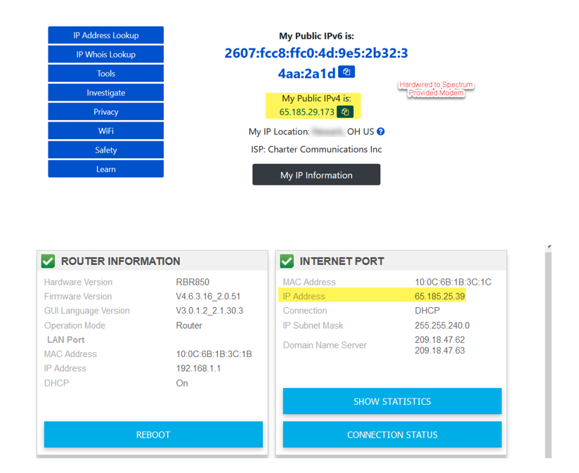

AX6000 (RBR850) Public IP Address not releasing ???
I just had a long converstation with Spectrum tech support (fully believing it was their faul) that they were issuing me an IP address that was outside of my local area. I live in central ohio but w...

Just got done factory resetting everything, re configuring the network and same results...still getting that Kentucky IP address. If I ethernet directly from Spectrum modem, I get the proper Ohio IP address.
Any other thoughts? I don't believe it's viable to discard $999 worth of network equipment because it won't release a public IP adddress.
- FURRYe38Feb 09, 2022Guru - Experienced User
Is the WAN IP Address your seeing the modem when directly connected to it, is it the same as what is being seen on the RBRs web page under Advanced Tab/Internet or something different?

See attached for image showing results from WhatismyIP hard wired from laptop to modem, then what the Orbi says when I am connected via wi-fi.
