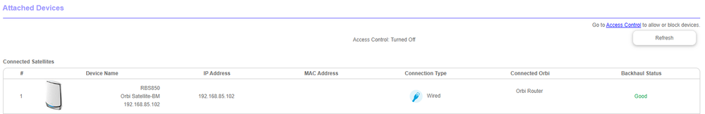

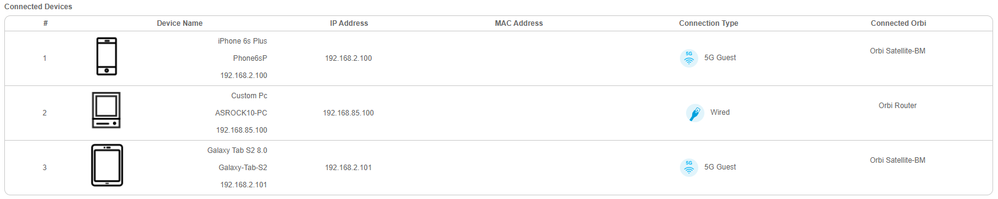

So I wanted to take another look at this today. I got my Orbi AX out and put it online. Router mode. RBS wired to RBR with 1 Gb non managed switch in between them. RBS connected first wirelessly then I conencted the ethernet cable. Both connections stable.

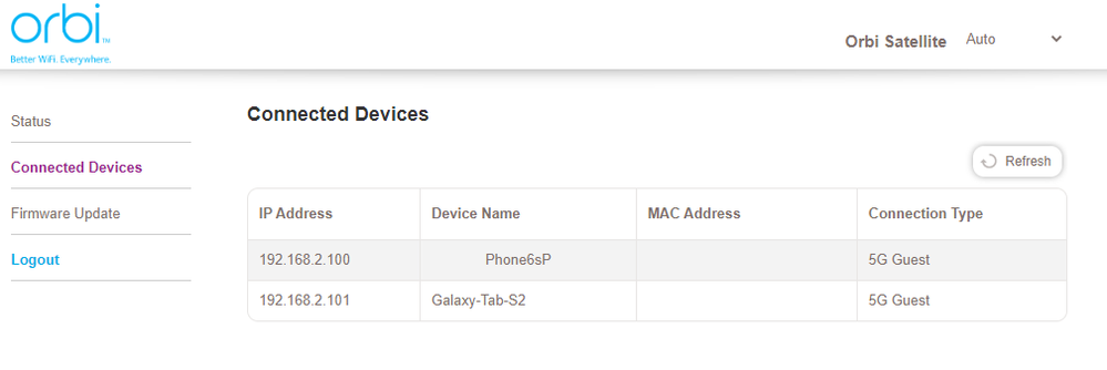

I enabled Guest network on the RBR first before getting the RBS. I can't tell from the RBS web page if Guest Network is running however checking my wifi analyzer I see two separate Guest Network SSIDs. I used default Netgear- Guest SSID name and gave my own PW. WPA2 and AES only.
Connected to devices to the Guest Network.
I found they were connected to the RBS:
RBR reported same 5G Guest on i'ts web page:
I see 5G Guest so this tells me they are connected to the Guest Network.

Ok, well I just tried again with 192.168.85.1 and enabled Access Controls and set Allow All. My two devices were connected at the wired RBS and still got internet services.
I then turned OFF the RBS, reconfigured 10.0.1.1 on the RBR and rebooted it. Guest Network and access controls still enabled. Powered ON the RBS. I disconnected my two devies while I waited for the RBS to cone to ready. Re-connected the wireless devices. They both connected and got internet services. Speed test app and youtube app both work
192.168.2.x is seen for any guest network devices. My wired PC and RBS behind the RBR has a 10.0.1.x address. Both wireless devices reported as 5G Guest under connection type.
