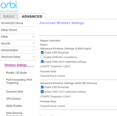

FURRYe38Yes, the original RBR50 Orbi still has the option to enable/disable broadcast of the SSID on the 2.4G and/or the 5G user channel:
This product is officially "End of Service", with the last firmware release in Feb, 2023.
Personally, I found this feature really helpful when dealing with those annoying Internet of Things gizmos that refused to set up when the smartphone app was connected to the router at 5G. Just disable broadcast SSID on 5G, forget the Orbi, reconnect at 2.4G, perform the setup, and then turn the broadcast back on. Easy Peasy.
