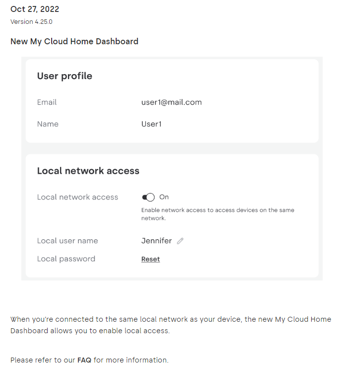

- eyalrtAug 29, 2023AspirantHi CrimpOn,
Thank you for investing time helping me.
I have tried this already. from the WD site, I can now log in as a remote user, or as a local user, which is the same, because it is from WD site.
Since the Orbi router doesn't detect or report the device, windows/linux (tried both) cannot detect it either. This is why it is a bug. If it cannot detect the device and it has no ip, it cannot access it.

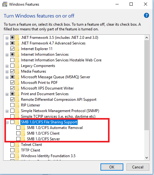

Have already enabled the Windows feature to enable the SMB 1.0/CIFS Client and SMB 1.0/CIFS Server (the automatic removal is not required - certain risk that if not making use of SMB 1.0/CIFS for a certain time it does disappear magically), and rebooted the system?
Once done so, I would expect the WD Cloud Home system to become visible. Some WD resources state only SMB2 and SMB3 is enabled by default. From what I understand, the current WD OS5 should be smb2 and smb3 only. But no idea on how these devices should appear on the average user desktop usually.
Start with the "discovery" using arp -a. Do a ping to the subnet, like 192.168.1.255 for example before.
