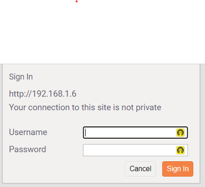

No go.
Disconnected all RBS's.
Generated new backhaul PW
Factory reset problematic RBS
Powered on, waited for white to stop flashing
Pressed Synch
Added new satellite from menu
It added and says link is good.
Cannot log onto the satellite. Takes username and pw but does nothing and blanks out the username and pw fields.
Note image below of "Attached Devices (Satellites) and then the Sign in screen for that RBS.
