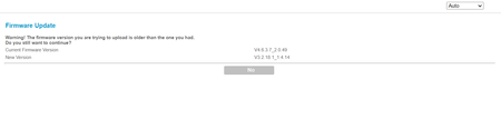

Can't downgrade FW on RBR750
Hi I've been having some ongoing issues with my Orbi setup (RB753) which official Netgear support suggested I downgrade the FW to solve (the poblems began when 4.6.3.7 auti-installed). I have...

Many thanks for your help, FURRYe38.
The link about using debug mode in Edge did indeed work - thank you for sharing it.
Downgrading the FW solved the issue but of course within an hour the router auto-updated the FW again. However support now tell me they have "elevated" the problem to a "higher tier". I imagine this means they will suggest I download the beta FW you have just mentioned.
Thanks again for your help.

Hi,
If you block 'devcom.up.netgear.com' and 'http.fw.updates1.netgear.com' - yes it really does need the 'http.' to be included - then the automatic firmware update will fail with "Service unavailable"
What was the trick to downgrade from v4 to v3 firmware? (found it)

- FodenDec 13, 2021Apprentice
Figured it out the hard way and then found the easy way - follow this https://community.netgear.com/t5/Orbi-WiFi-6-AX-and-WiFi-6E-AXE/RBK750-Series-Firmware-Update-v4-6-3-7/m-p/2130584#M18586 (Post 77 and/or 78)
Am now on V3.2.18.1_1.4.14 on the router, going to downgrade the satellite now
Absolutley ridiculous process to go throught to try and get your router working the way its supposed to out of the box!
