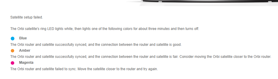

I have the "Setup failed" message in the web console when adding the new satellite. The LED is off on the satellite.
