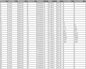

CBR750 intermittent internet with Spectrum
Attached is an image of the first 31 channels that my cable connection has, seems like 11-19 have significant issues I had spectrum come out and they stated there was no issue on their end which seem...

Its still indicating a line issue. It could be in your home or it could be the run to your home.
Start with removing any amplifiers, signal attenuators, or splitters from the coax.
From there check the line for kinks, damage, moisture in the line.
Check the connectors for improperly made ends, foil touching the copper coax line, bad/old/cheap connectors, or corroded connections. Replace them if you do.
If you can, simply connect the modem right where the coax comes into the home. This prevents wiring in the home from being the issue. And some ISP’s charge if the wiring issue is in the home. So this helps prevent this.

I already replaced the line coming in with quad shielded cable and it is a direct line from my outdoor tap... So not the issue, all the fittings are good to go now still had intermittent things occur during the day...uncorrectable packets issue comes and goes too...

Did you try directly connecting it where the line comes in?
I had an instance once where a drywaller had put a screw through the coax cable in the wall. it still worked but had occasional drops. I've also seen where the foil is touching the copper when people did it themselves and caused issues. Not saying you did. Just saying, its worth directly connecting it. Plus if you're still getting the errors directly connected, it limits what spectrum can blame it on- go1dens4Jun 27, 2022Tutor
I re-ran the drop into my house... aka this is where it comes in... My father worked in the cable industry so I have all the tools to run drops, the cable is good to go into my house it is a single line directly connected to my outside drop.
