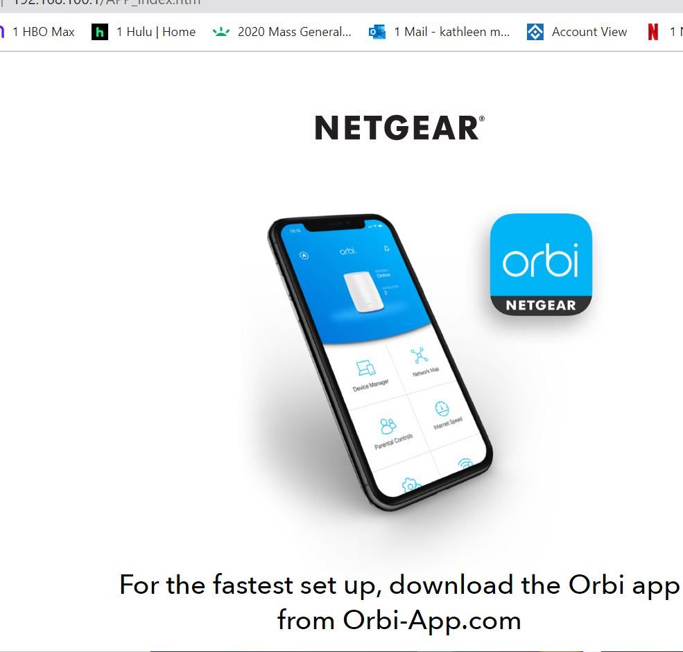

I can connect my pc to the ip address and it brings me to this screen below. I can then go through the setup process (same exact steps as on the netgear phone app) - it allows me to set up a new admin password, security questions, set up the network name and password, and then I an get into the orbi app, firmware V4.6.6.8_2.0.54. /but then when asked to connect to the network, get the same header error that I sent previously
- FURRYe38Sep 12, 2022Guru - Experienced User
You don't need to use Orbi app after you factory reset. Use a wired PC and web browser to walk thru the setup wizard. If you see a question are you connected to the network, just select I'm connected to the network. Skip any FW update checking and registration. Should get you to the home screen of the CBR.
