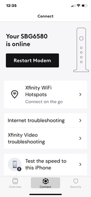

Can you post a picture of what the CC app looks like showing the modem off line with the CBR connected?

- slosrt8Dec 20, 2022Tutor
So talking with the tech on Saturday he showed me his phone will all his tools and my account showed offline. He pulled up my neighbors account and everything was green. He also pulled up my history of modems on his phone and pulled up the CAX80 and it showed online and active and then pulled up the G36 showed online and active. He then pulled up the Amazon CBR750 and it showed the same status as my replacement offline and not connected. Here are the screenshots you requested from the CC app. The sn is correct it was checked by the tech on saturday. While he was in my house he sent the modem a signal and it never responded as it is showing offline.
- slosrt8Dec 21, 2022Tutor
So to update. After installing the FW you sent me, I still have the same issue. The modem is showing offline (not connected) on the CC app. I also contacted the tech who was here on Saturday to have him pull it up on his side and he is still showing the modem not transmitting and offline.
