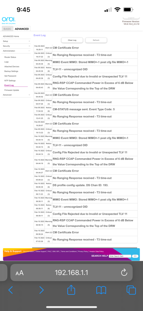

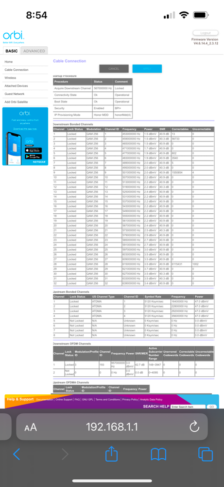

I see some Correct and Un-Correctables that should be zero'd like the other channels.
Power look ok.

Those Criticals need to be looked at and reviewed by the ISP. The CM Certificate Errors should be resolved as well seen in the event log.
