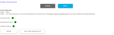

- cshep5528Jan 12, 2023Star
connection = good

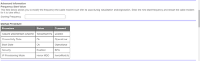

https://kb.netgear.com/30007/How-do-I-obtain-the-cable-connection-information-from-a-NETGEAR-cable-modem-modem-router- cshep5528Jan 20, 2023Star
Here is a copy of it
- FURRYe38Jan 20, 2023Guru - Experienced User
See Errors and Criticals in the event logs that the ISP needs to review and resolve.
Please post a capture of the cable connections page in this entirety please.
