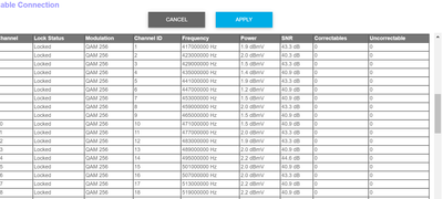

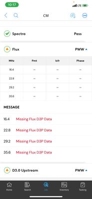

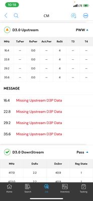

Xfinity came over again reduced power on the line to ~2. This was yesterday and it already went out today. Tech was very thurough and send me the below screenshots as far as he can see. Indicates the problem is with the modem. Also been 3 weeks and still havent heard back from "customer care" which appears to have been named ironically.
Comcast tech indicated that it is not picking up flux or some kind of upstream or downstream channels cant remember which one he said.
