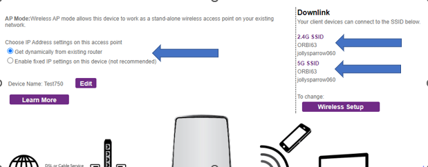

- In addition, the RBR750 AP/Router mode display is unusual:
Notice that it does not mention the Guest WiFi SSID, even though two devices ARE connected to the Guest WiFi SSID. Pulling up the Help information at the bottom of the screen claims that Guest WiFi is not available. The RBR750 User Manual does not mention what is "not available" when the device is in AP mode.
