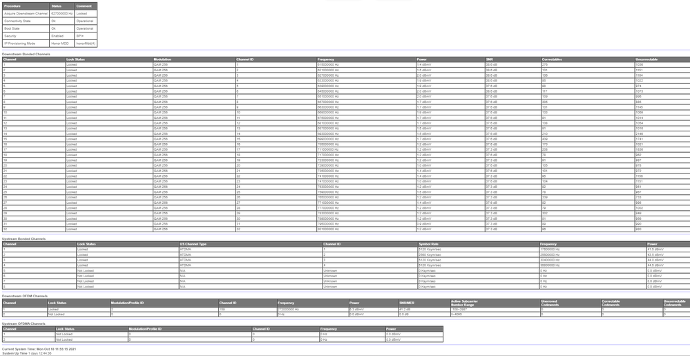

  • FURRYe38's avatar
    Please post a copy and paste of the modems connection status page.
    Have the ISP check the signal and line quality UP to the modem. Be sure the ISP provisions the modem correctly.

      • Hoopladoodle's avatar
        Hoopladoodle
        Tutor
        Screenshot of the up/downstream bonded channels attached as in-post photo doesn't seem to work:
