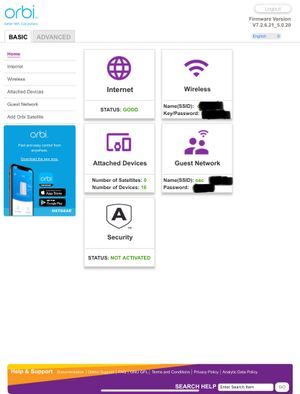

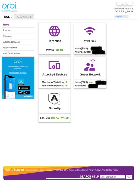

I have problem with connecting new RBS850 to my RBR850. I bought second satellite, and can't connect it. Even when there is info about successful connection, the satellite isn't visible. Also when...

however I did this different way. Connected to router by cable, search in attached devices, look what IP address is, login that way, and updated. After that it appeared as a satellite.
