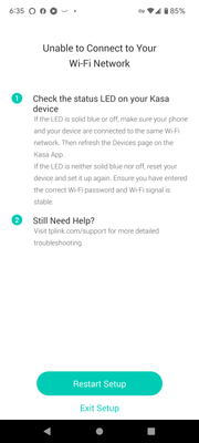

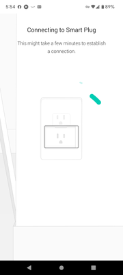

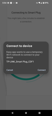

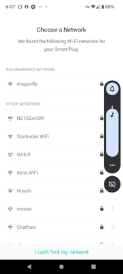

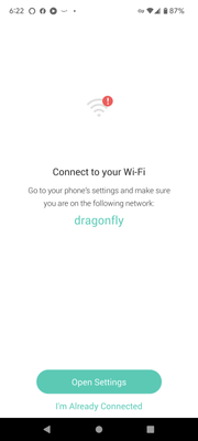

I just read through the steps for about the 100th time and notice something I hadn't paid attention to. I've attached 4 screenshots starting at Connecting to Smart Plug. I make sure the plug is flashing orange and blue before I start. Please note that I don't always get the 2nd screenshot after the connection screen. Usually, it just goes to the list of wifi's (3rd screenshot) so I assumed it wanted me to log into my network. But the prompt in the 2nd screenshot leads me to believe that the Kasa app wants to connect to the temporary TP-Link_SmartPlug_CDF1 wifi. After clicking Connect I got the Choose a Network screen (3rd screenshot) where I do not see the temporary network so instead I tried choosing my orbi wifi at which point it asks me for the password. I auto-fill that from my password manager to connect, and then it then goes to the 4th screenshot. If I try clicking I'm Already Connected, it tries connecting but I eventually get the 5th screenshot. At this point the plug is still flashing orange and blue but at a slower pace.
Any additional thoughts? Also, which is it trying to connect to after the 3rd screenshot...the temporary TP-Link wifi or my orbi wifi?
