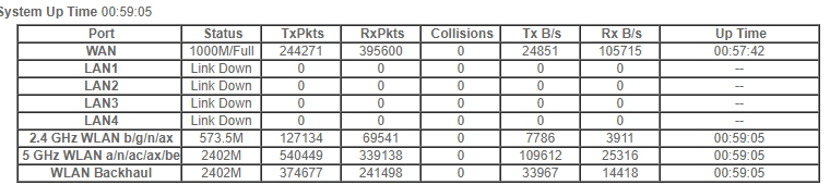

Can you take screen captures of the RBR and each RBS debug pages that show all the data from System Up Time and up on this page please?
What does the Up time show on the RBRs web page under advanced tab/show stats on the WAN port.

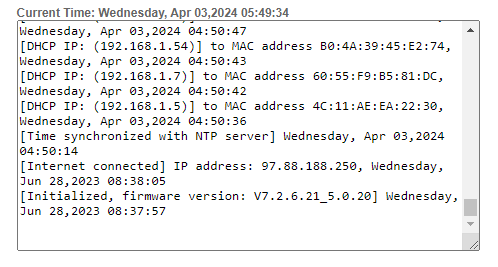

Does the RBRs log feature show any reboots or access to the internet?
Basic Information
Firmware Version: V7.2.6.21_5.0.20
Boot Loader Version: V1.0.13
seal: v2.1.5.49-0
seal_services: v2.1.5.20-0
armor-bd: v2.2.100.3
spc-circle: v3.31.1.2
CPU Load: 46.11%
Memory Usage(Used/Total): 355 MB/874 MB
System Uptime: 0 days 00:53:28
Does the RBRs log feature show any reboots or access to the internet? Everything is looking like a reboot happened but not seeing it in those terms but not everything is connecting back.
