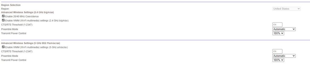

Also, I am not seeing a way to adjust the transmit power of just the Satellite?

Under Advanced Tab/Advanced Settings/Wireless Settings

There is no setting there to adjust the transmit power on just the satellite.
