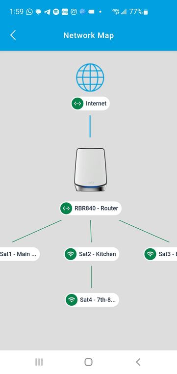

CrimpOn wrote:How does the Orbi Attached Devices display report the satellite connections to the router (and the Daisy Chain) to Building E? Do they all show as "5G Good"? What does it report about those Apple laptop connections?
I am no longer there today to be able to check on that display, but previously I remember the connections all showing as "Good." Here is what I see on the Orbi remote accessing remotely. All of them show as connected by 5 Ghz
