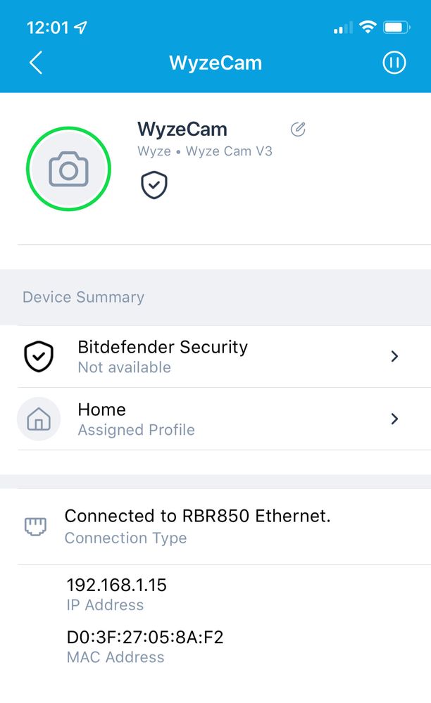

1-I did not disable the wifi on the camera because I do not see a way to do that. I just rebooted it. It still connected to the router.
2-This device (the camera) also shows that it’s connected to the router via Ethernet. It is not. I thought that was strange.

Sorry, one more Q. Why do some of my devices show as connected via Ethernet when they are not? For example, this is the camera I was talking about that will only connect to the router even though the satellite is closer. It says it's connected via Ethernet. It doesn't even have an ethernet port. It's 100% wi-fi. Tks!
