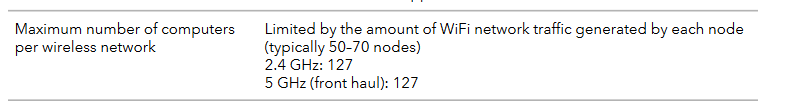

        Page 155 of the user manual says this:
        This gives the impression that this router is not suitable for your intended use.
        If the router is put into access point mode and an external DHCP server is used, it would be interesting to know "what happens" when more than this number of IP addresses are active on the network at the same time using a /23 subnet mask.
