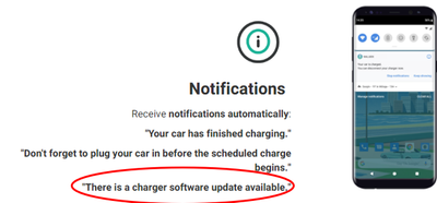

I have a feeling that the problem is stated incorrectly: "Updates to the app..." This is an Android app that was downloaded from Google Play. This app will be updated the same way it was installed in the first place: through Google Play. Perhaps the problem is instead that the app has provided a notification that there is new software for the charger itself.
It appears to me that the charger software can be updated without using WiFi at all (i.e. with Bluetooth):
If the issue is how to connect the charger to WiFi so that the app can reach the charger when not within Bluetooth range, my guess is that Band Steering is not the problem.
