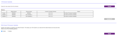

- carlssonSep 08, 2023Star
What's a Power Line adapter, and should that really be necessary? (I don't want to draw cables in this old house, it's not made for that, hence the Mesh solution)
I'll try to just disconnect S1 and see what happens.
Eventually I will have my home office in the attic, then they will even be more separated.
I thought I had the latest firmware, since it updated when I installed it yesterday. But I see now that I have version 4, and the URL you provided has v7… 😬
So manual update then?
Thanks again!
